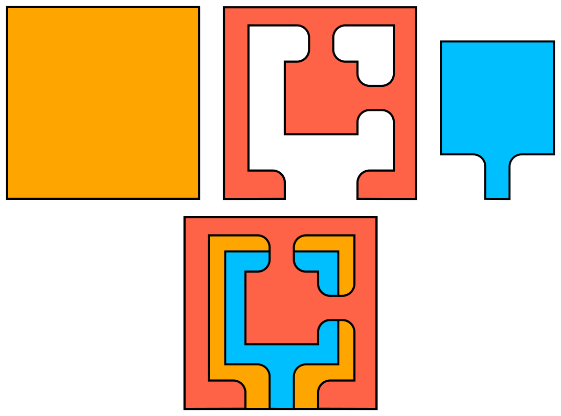

Here's an alternate version of what you might do but unlike Polygon's this makes some assumptions about the coloring intent that are probably wrong! But the file is tiny though.
- drawing.svg
- (10.01 KiB) Downloaded 83 times
