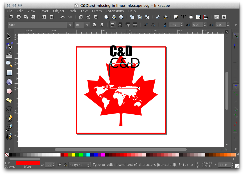

There were two! interesting glitches in your file.Maybe three.
1. The font was displaying in Impact even though you had used Sans. The screenshot you attached also showed Impact! So I guess this is a font naming glitch, perhaps your linux system does not have this font.
2. Your original file had the fill color of the text object as RED when selected using
but as WHITE when slected using
! Look in the lower left of the Inkscape window to see the fill color of selected objects. I do not know why this might be, frankly, and I could not recreate the condition again once it was corrected. this might be a known bug... But obviously the Linux system displayed it correctly, and therefore the red text vanished on a red background.
and start typing to create a text object. No need to drag a box, which creates a flowed text object with some different properties.Here is a screenshot of what the two fonts look like on my system, just for reference. Some fonts are not availble in inkscape at all! So I just have to tell you verbally that Basic sans heavy looks a lot like Impact. What this might have to do with anything is anyone's guess! My advice is to always always always convert text objects to paths if you want it to render correctly on anyone else's system!
! Look in the lower left of the Inkscape window to see the fill color of selected objects. I do not know why this might be, frankly, and I could not recreate the condition again once it was corrected. this might be a known bug... But obviously the Linux system displayed it correctly, and therefore the red text vanished on a red background.Off topic:
3. What reason do you have for creating this text as a flowed object? In inkscape you just need to click with the

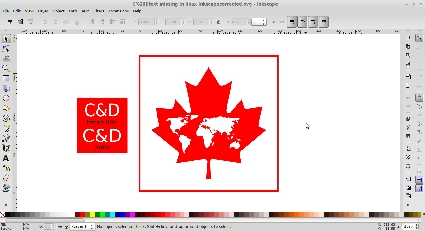

I opened the file you created in my Linux Inkscape and printed the screen. See screenshot here:
download/file.php"uncited">
If I have Impact on my Linux computer, what problem will this solve?

I can't see the text C&D text box at all in Linux Inkscape, and I've tried ungrouping and selecting the entire drawing. The C&D text box is nowhere to be found.

Thanks for taking the time to look into this (3-headed) problem with me.

- Screenshot-C%26Dtext missing in linux inkscapecorrected.svg - Inkscape.png (113.74 KiB) Viewed 1918 times
Re: Vector file created in Win7 Inkscape is incomplete in Li
inksquid wrote:If I have Impact on my Linux computer, what problem will this solve?
Maybe none. On Windows, Inscape substitutes the closest font, in style, on the current machine, for missing fonts. I don't know if Linux does this or just does not display the object at all. If the latter, this would be the reason your text is just gone.
If not for the reason above, then maybe it's visible in outline view? you have probably tried that but sometimes people forget about outline view. See attached bitmap.inksquid wrote:The C&D text box is nowhere to be found.
Absolutely. However for such a short text string the benefits of conversion outweigh the disadvantges by a long shot! See the attached svg for an example of hiding the original text in a blind layer and converting a copy. Also I have combined all the red paths into one. So just one white fill, one red fill. Hard for the display to mess up!inksquid wrote:But what if I later want to change the text? Won't paths be problematic?
Pleas see ~suv's post below with much more accurate info about font substitution and the whole issue!

Flowed text truncated to 0 (zero) characters is neither visible nor selectable in Inkscape (there are selection methods which allow to detect them, and there is a report tracking this issue). If needed I can provide more details for the known workarounds. However - the best recommendation here would be to not use flowed text unless really needed (as was mentioned already by druban): for a single-line 3-letter logo text, working with regular text is best.
inksquid wrote: (…) and even when I view the file in Linux Firefox browser and Linux Google Chrome, the white text is missing.
It's missing because Inkscape's 'Flowed Text' implementation is proprietary (unfortunately without including a fallback version in the SVG file), and cannot be rendered by other SVG viewers (including web browsers), no matter on which OS/platform they run.
