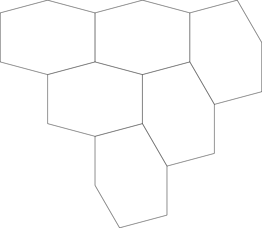

Is there a way to set up the axonometric grid (or a combination of 2 grids) to be able to create a pattern of rectangular hexes like in the picture below. The top left corner of the hex has a angle of 115 degrees and all hex segment has the same size.
- Retangular hex pattern
- Deformed_hex.jpg (63.25 KiB) Viewed 5220 times

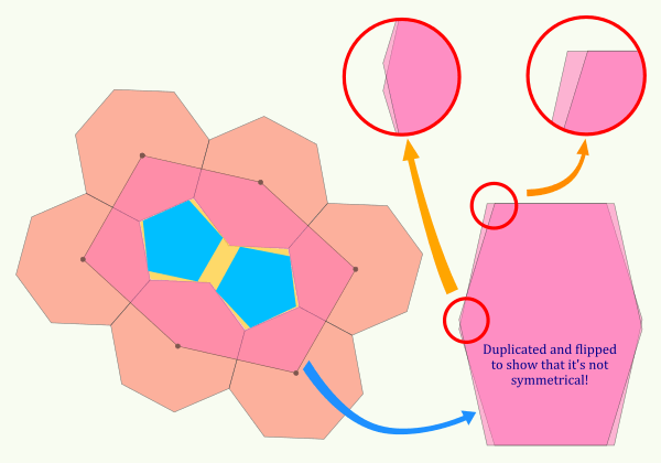

I tried to reproduce your drawing but remembered a tiling fallacy that looks deceptively possible but is not: It's not possible to arrange hepatagons and pentagons in a regular tiling as in your diagram! Very close, but off by

My error, it's 105 degrees
Why do you want a grid? This is quite easy to do as a pattern or as a tiled clone, but are those solutions not applicable to your needs?
I have used something similar to the tiled clone to make the initial grid. But as you can see, it is possible to rotate the hex and still make it fit in the pattern. So I am using a combination of straight and rotated hex. Since the shape does not fit with an axonometric grid, there is no way to snap the shapes and that is very annoying since I need to move everything manually (calculate measurements by trial and error).

I made some test with the grids. In theory, if you use an angle of 15 degress for the first grid and 60 degress for the second grid, you should have all the right rangles for all the line of the patterns.
The problem is the alignment of the vertex, they never match the grid.
For example, if the length of a side is 10, according to "Pythagorean trigonometric identity" found on wiki pedia, the widh of the hex should be approximately: 19.31851652. How I am suppose to fit the other end of the hex on the grid, it's impossible. In fact, I can only fit 2 or 6 vertex on a grid (3 segments) . Unless I can snap to vertex, there is no way I will have a precise hex, I can only use my eye and estimate the hex is connected correctly. So even a single hex will be very imprecise.
I think snapping to vertex would be the only solution. I am not sure if Inkscape has that feature.
