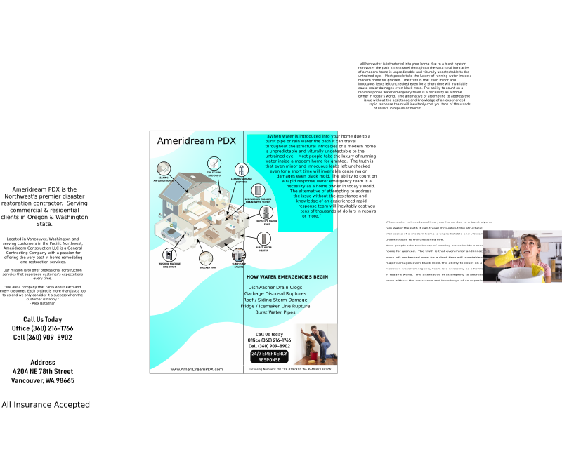

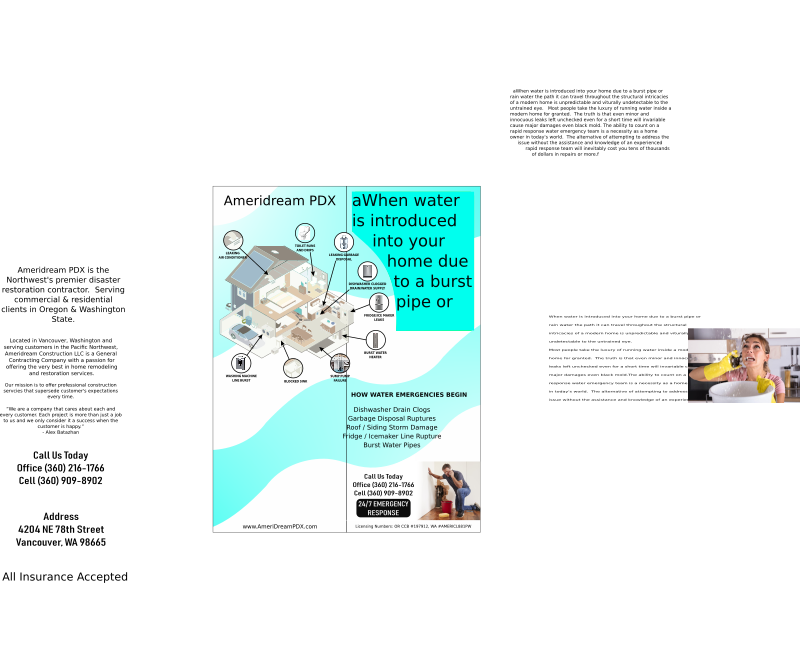

Here is the issue that I literally wanted to throw coffee at my screen. Flow into frame:
I could only get certain paths to work with this feature, so I created a frame by hand to simply wrap some text around a graphic. NO MATTER WHAT I DO!!! IT KEEPS RESIZING MY TEXT TO A HUGE FONT SIZE, then when I change the font size small again, it creates a huge gap between the lines, for which there is no line height setting known to me. I've been trying to get around this for about an hour and it is so infuriating and frustrating.
Also I created a line of text and it would only paste part of it into the frame at one point, and I tried several times, I have no idea what that's about.
Lastly it linked the flow into frame with a paragraph parially, but not completely, and when I copied that paragraph across the screen, it also had the half way linked shape of the path. Exhaustively, unbelievable mind bogglingly, pull your hair out, problematic.
