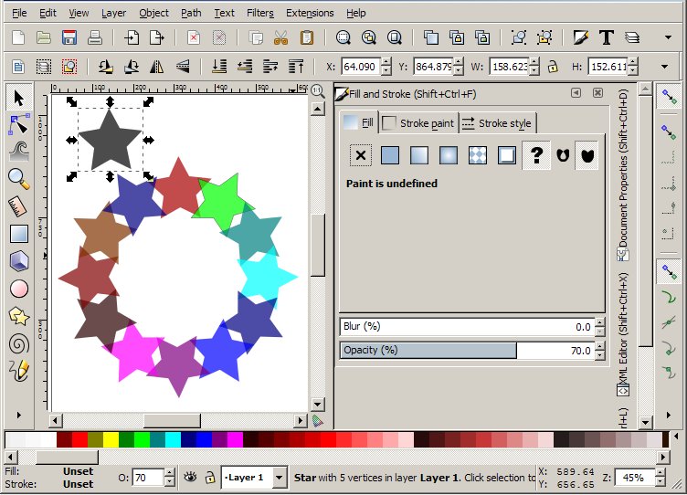

As Xav points out, the color of the original can be unset, allowing the clones to be other colors; but still controlled by the original for other attributes.
Note that the object-opacity of the clones is controlled by the original and the clones.
(Seems like the alpha of the clone fill is dictated by the original, but the stroke is not? Anyone?)
Did you forget to make the stroke unset?

Stroke and fill are both unset (see pic)... I rekon it's a bug.Have a nice day.
Re: tiled clones turn to bitmaps
Oh, I see you are using 0.91 pre2. In your screenshot, it's only that green clone, where the stroke is different. Is the original object under the green clone? Unless I'm just not clear what you mean?
