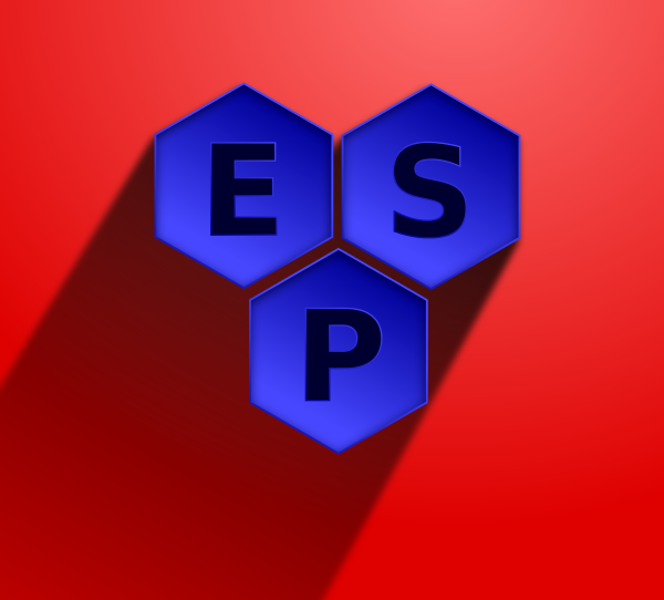

Was toying around with an inner shadow and a longshadow and lighting in general. Not sure i got the direction of light correct.
What do y'all think ?

Very nice! I like the effect of the concave surface of the buttons or keys or whatever they are. The lighting and shadow looks ok to me. ....well....maybe the cast shadow is just a hair off.... Maybe not, it's hard to say. Maybe the far end of the cast shadow should be shaped like the edges of buttons?
The only problem I see is that the shadow of the E and the shadow of the P is darker where they overlap. I'm not sure if that would happen in real life. Maybe it would....this is one of those things where I'd have to set up the situation in front of me.... Like maybe with stacks of coins....or maybe find some bottle caps or something.
Nice work
Nice work
Re: Shadows
brynn wrote:I'm not sure if that would happen in real life.
Me neither
EDIT: just tried with a flashlight.
It seem the shadows merge and they dont fade out. They just blur a bit....
That better ?

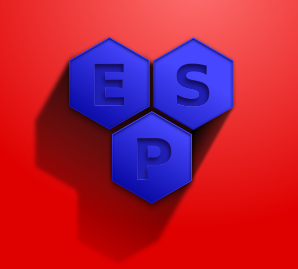

It looks kind of boring....
- Shades3.png (96.63 KiB) Viewed 2742 times
- Shades2.png (92.11 KiB) Viewed 2742 times

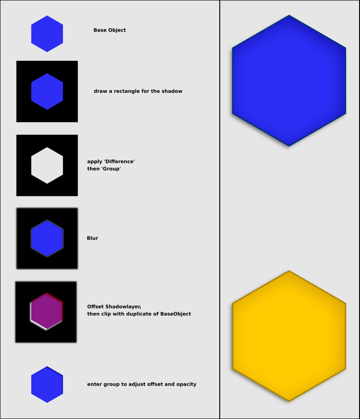

My Gimp technique translated into Inkscape.

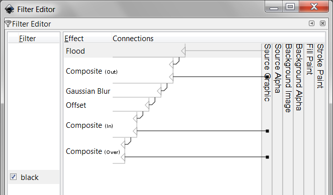

Re: Shadows
^--filter new
flood fill with black&alpha value
composite out
gaussian blur
offset
composite in
composite over
composite out
gaussian blur
offset
composite in
composite over
Re: Shadows
That better ?
Make the gradient on the shadow the same as in the first one. That was very effective.
I mean keep the new shape for the shadow, but use the same gradient as before -- where it goes to 0 alpha
Re: Shadows
Lazur URH wrote:^--filter new
composite out
gaussian blur
offset
composite in
composite over

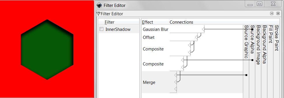

This doesnt seem to include the original object.
Heres what i came up with (problem: the shadow is always black):
Gaussian Blur
Offset
Composite (In)
Composite (Out)
Merge
- InnerShadowFilter.png (33.76 KiB) Viewed 2735 times
Re: Shadows
brynn wrote:Make the gradient on the shadow the same as in the first one. That was very effective.
The problem with that approach is: the lower part is longer than the upper, which means the longer part will be more faded out then the upper....

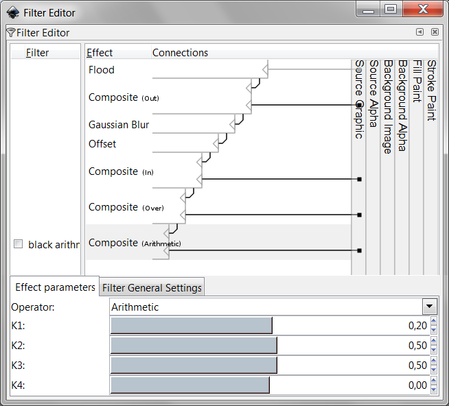

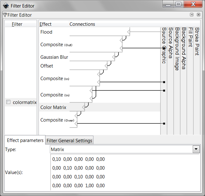

I added screenshots for the Lazur filters, in case anybody wants to build them.
- LazurInnerFilter_Black arithmetic.png (41.4 KiB) Viewed 2615 times
- LazurInnerFilter_colormatrix.png (40.81 KiB) Viewed 2615 times
- LazurInnerFilter_blk.png (29.25 KiB) Viewed 2615 times
