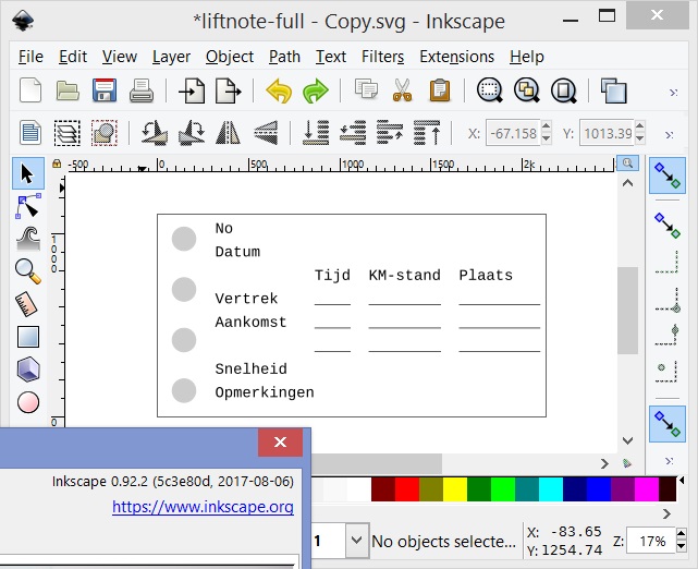

FWIW, it opens within reason in Inkscape 0.92.2 (5c3e80d, 2017-08-06), 64 bit win8.1
Substituted font with "Liberation Mono".
