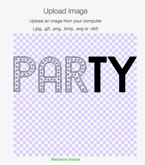

I've been battling this issue for a while now, it only happens with certain fonts. I would love to solve this issue. I make cut files for cricut/silhouette etc. So, I always be sure to save each file as a dxf for silhouette users. However, sometimes my font does this weird thing. Does anyone have a solution? I have tried everything. The font should look like the first 3 letters, the last 2 letters shouldn't have that solid fill. Which means this will not cut properly.
- ss.jpg (71.24 KiB) Viewed 1485 times

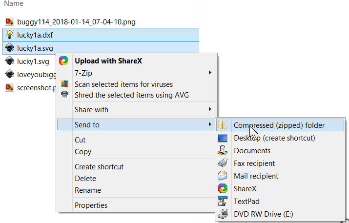

Best to provide an example svg and the resulting dxf. You can put the files in a zip-file like this.
Then, attach the zip-file like you have done with the jpg.

This is likely a DS issue.
The dxf file opens fine in a number of professional programs here...
I'd ask Kay at http://cleversomeday.com/ what she thinks about this.
