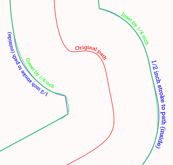

You can set the inset and outset to the units and step size you want (step size is set in preferences) so that it is exactly the distance you want from your original in ONE step, to have the fewest alterations in the geometry, but of course you understand that it us impossible to preserve all the little shapes and still have the new path be x units from the old path at every point along its length?
You can also set the stroke to TWICE the distance you want e.g. if you want the new path to be 1/4 inch from the original, then you have to use a 1/2 inch stroke (use the fill and stroke dialog to set amount and units in the stroke style tab), and then do path menu>stroke to path, pathmenu>break apart, and delete the path you don't want.
The two methods yield slightly different results, but are very close to each other in most areas. This is a close up of your file with the two methods in different colors.
