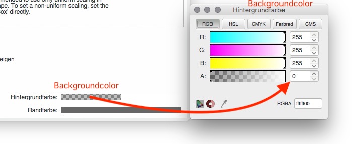

Make sure no objects with opaque colours are under your design and @ the document-properties (shift+cmd+D) background color is set to 100% transparency: 0
