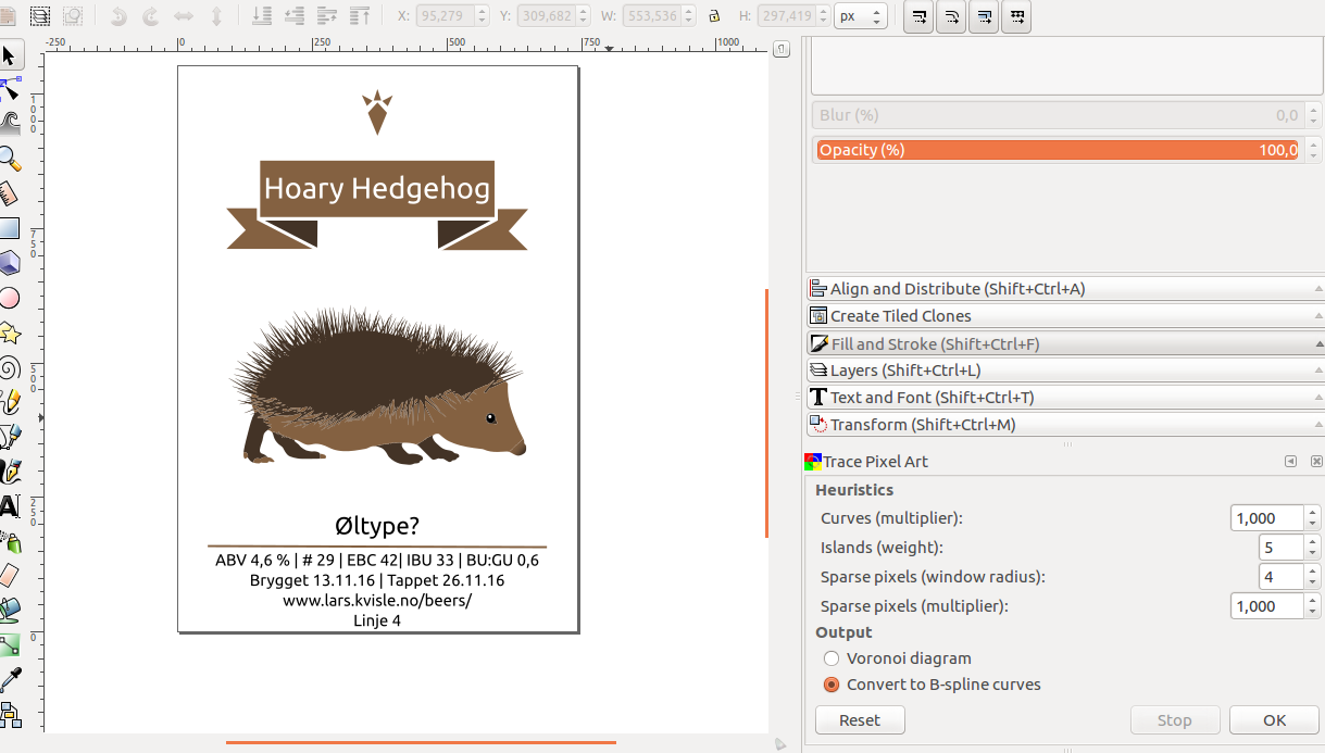

I've got an odd problem I'm unable to figure out. When printing an svg-file an object is missing. I'll provide the .svg, a screenshot and a .pdf. What in the world am I doing wrong?

- missing-hedgehog.png (149.46 KiB) Viewed 974 times

First guess you have a very thin stroke set on the missing object which is a cairo bug if I'm not mistaken.
Checking.
Edit: yes, that's it. Hedgehog having a 0,031 px wide stroke set.
Removing it/setting it wider should solve the problem.
Checking.
Re: Missing object
Found the same... changing stroke to 0.1px resolves the issue here.

Great! Changing stroke made all the difference. I would never have found that error on my own. Thanks a lot!
