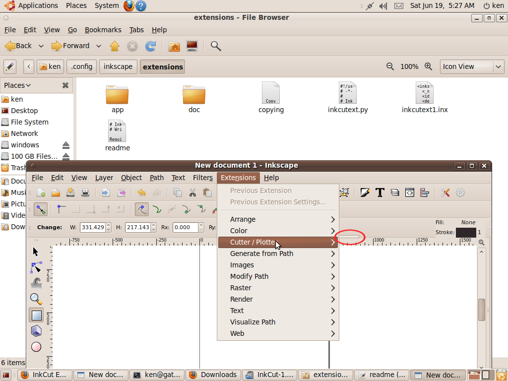

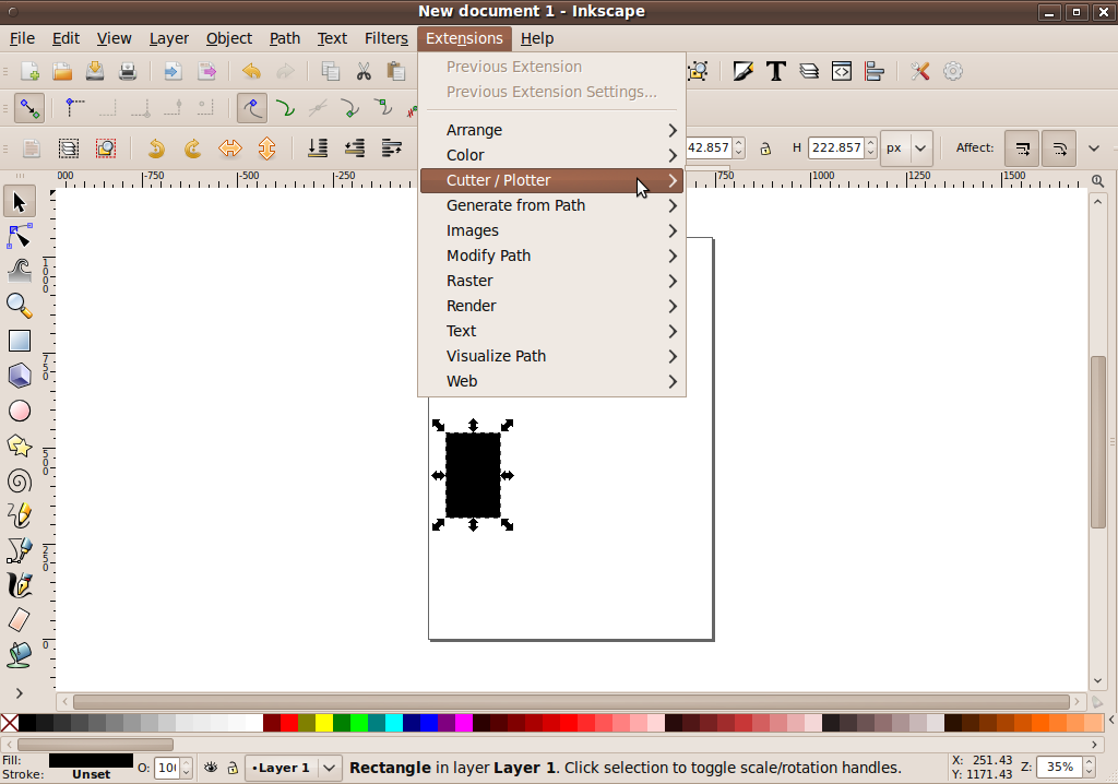

i havent tried ver 1.0 untill today
what am i doing wrong i have everything moved to the extensions folder and i do have python installed
here is a pic of inkscape
all that shows up is a small rectangle next to inkcut in the drop down
- Screenshot-New document 1 - Inkscape.png (107.96 KiB) Viewed 31391 times

Re: InkCut Extension, send HPGL directly to cutter from Inkscape
kmrs75 wrote:i havent tried ver 1.0 untill today
Post this, seems as if i may have not had something setup right...
Code: Select all
ls .config/inkscape/extensions/It doesn't show up in the menu at all then?

sorry i have been gone a while been working alot everyday since may - but im back on and off still working alot
here is what you requested
ken@gateway-desktop:~$ ls .config/inkscape/extensions/
app copying doc inkcutext1.inx inkcutext.py readme
i removed all the files and tried it again but still getting just a small drop down no options here is another pic of it so you can see it
