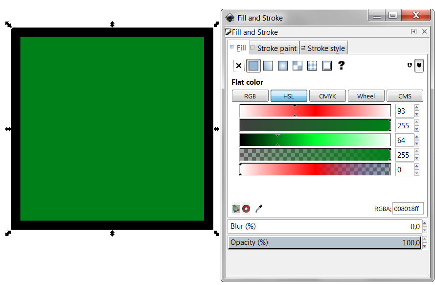

The Fill dialogue under HSL does funny things...
Installing 0.92 and first bug
- Hue Bug.png (39.95 KiB) Viewed 2234 times

0.92 has some issues with HSL:
https://bugs.launchpad.net/inkscape/+bug/1635982
There are some other related... feel free to add your "me too" to any you think qualify.

Thanks tyler !
Uninstalled 0.92, reinstalled 0.91, then used revo uninstaller to take care of the mess.
Finally got rid of the semi uninstalled garbage and installed 0.92 - 32 bit.
HSL bug is apparently a 64bit problem.
So im good for now.

... yeah... I was about to post this: https://launchpad.net/inkscape/+milestone/0.92 on another thread saying "I wouldn't expect the release before the majority of these bugs get addressed".
Apparently I was wrong. I don't know, I might wait until 0.92.1

I get the HSL bug, too, on Linux. I'm still unsure if I should upgrade before 0.92.1, because of the amount of relevant issues with text, scaling and my favourite way of color selection, but will compile an additional version 0.92 to sit on my disk for being able to answer user questions.
