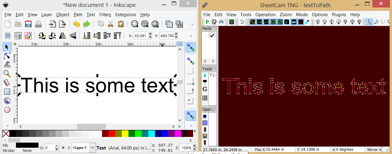

Re: Newbie Needs Help
Might help to post your Inkscape version, system info and dxf settings... object to path seems pretty good here.
- 2017-02-07_20-43-56.png (84.85 KiB) Viewed 1927 times

Hey Tyler Nice screen shot...Thank You! Im using 0.092 also, i just downloaded it 2/6. watched a video on how to manipulate text and got it. when I save the text as dxf,it pops a window up which has Desktop Cutting Plotter (AutoCad DXF R14)*.DXF<----I save it as drawing1.DXF...It will out put all Lines But NO Radius. I also Use AutoDesk Inventor Fusion360...when i bring it up in Inventor it shows only lines no radius...
Oh.. when I save it;there is another window that pops up...DeskTop Cutting Plotter in it i have Robomaster type Spline Unchecked...LWPOLYLINE Unchecked....Base Unit:inches... Encoding:UTF8...Layer Export:ALL .....then click ok...and it saves it just fine ...just no radius....
