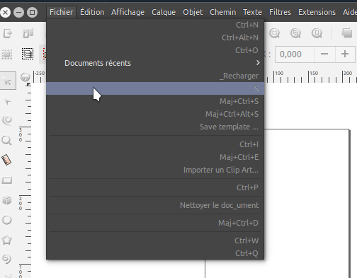

Hi all,
My Ubuntu 16.04/unity with xenial inkscape-trunk ppa installed.
I have an issue about menus that doen't display correctly.
If i install the old "inkscape-trunk-gtk3" package, the menus are back and display correctly.
So, do you know a workaround to make the menus display correctly in the last trunk packages.
inkscape-trunk: Menus are not display well

It's an issue with unity only. It works well with Gnome, Kde, Mate ....
If i launch it from an other account with default config or from guest account, the issue is always here with unity only...
