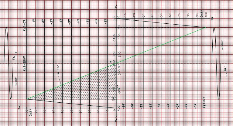

Let me give some background why I want to make a Cartesian millimeter grid using Inkscape.
I am running PCLinuxOS 64bit on my computer (left Windows about a year ago) and as replacement for Serif's "DrawPLus" X6 I am using Inkscape to do the job.
While preparing a little booklet with solved problems concerning vacuum tube amplifier basics, I just need a millimeter grid to draw some characteristics. In the past I simply took a jpg file with that grid on it and draw those characteristics on it using a new layer.
Then I decided to do things in Inkscape using its lattice possibilities which, as I now see, turned into a little disaster.
In the attachment I give an example what I was intending to do. Hope somebody can give me help to do things correctly.
- Opg.10-Ia-Va-Vg1-crop.jpg (133.82 KiB) Viewed 3569 times

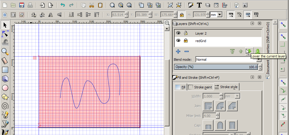

add a document grid ; shift ctrl d=> grid millimeter ; main grid every 10;
move "your" grid to a layer and hide/show it when necessary (shift ctrl l)
draw in another layer

Yeah, grids that you draw in Inkscape, as opposed to the grids that Inkscape provides for snapping (precision) (which are not part of the drawing) tend to bog things down terribly.
If you don't need to edit the grid anymore, or you don't need to edit much, you could try converting it to a pattern. Or maybe Edit menu > Make a Bitmap Copy, which turns it into an image (PNG)..... Although.....well, you can experiment. I'm not sure if Bitmap Copy would help or not. But I think it should help some.
Here's how to make it a pattern:
1 -- Draw a rectangle that fits the outer edge of the grid.
2 -- Select the grid and do Object menu > Patterns > Object to Pattern.
3 -- Select the new rectangle and do Object menu > Fill and Stroke > Fill tab, and click the Pattern button, which looks like blurry white dots on a light blue background. There you will find a dropdown menu of all the patterns that Inkscape provides, and at the top will be your new custom pattern. It will be named something like "Pattern1234"
4 -- Click Pattern1234 to apply the pattern to the rectangle
It's possible you'll need to adjust the pattern to fit the rectangle. I have a vague memory of explaining how to do that for you, some weeks ago. But I could be thinking of someone else. If you need to adjust the pattern in the rectangle, first select it with the Selection tool. Then switch to the Node tool. This will reveal the pattern handles, which are a tiny X, a tiny square and a tiny circle.
The X handle will be in the top, left corner of wherever the grid was when you converted to a pattern. Although it could be anywhere on the canvas. When you find it, you can grab it and drag the pattern closer to the rectangle, so you can see what you're doing. If necessary, you can make it larger or smaller with the square handle (be sure to hold Ctrl, to keep proportions). (The circle handle rotates the pattern.)
__________________
Here are some other tips for dealing with performance issues with Inkscape. http://forum.inkscapecommunity.com/inde ... article=35
The best would probably be using layers, and hiding the grid layer when you don't need it.
I don't know how much work it would be, or even for sure if it would work. But theoretically, you could set up the kind of grid that Inkscape provides for precision and snapping, that is identical to the grid you've drawn with an extension, and align them. Then you could hide the grid made of paths in a hidden layer, and use the other grid to snap your drawing to. Then when you get ready to export the image, or whatever you're going to do with it, hide the snapping grid and unhide the paths grid.
