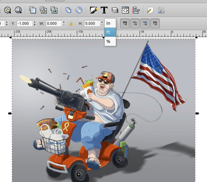

brucewestfall
- Posts: 12
- Joined: Tue Apr 08, 2008 1:17 am
brucewestfall
- Posts: 12
Re: Where did FEET go in 0.92??
Thanks to Eduard Braun who gave a perfect solution:
you can easily restore "feet" to the list of usable units
by modifying the file "/usr/share/inkscape/ui/units.xml"
add this below centimeters:
<unit type="LINEAR" pri="n">
<name>foot</name>
<plural>feet</plural>
<abbr>ft</abbr>
<factor>1152</factor>
<description>Feet (12 in/ft)</description>
</unit>
I also was able to remove those pesky logical and amazingly useful units I never use.
Now I don't have to move to Belgium!
Gonna put on my pajamas and go to Walmart!
brucewestfall wrote:Gonna put on my pajamas and go to Walmart!
Loool
