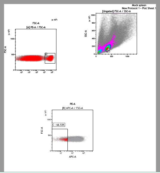

Either I don't understand the problem, or I can't reproduce it.
When you said you opened the file, ungrouped and moved some graphs, do you mean that where you moved them, is not where we see them, in Test3.pdf?
Attached is what I see in Test3.pdf, using Adobe Reader.
- test3.png (48.11 KiB) Viewed 2447 times
Re: Problem with modifying a specific .pdf file
Yes, I see the same as what you posted. So the problem is that the quality is very low. In Test1 you can see the individual dots and in Test3 everything is blurry.

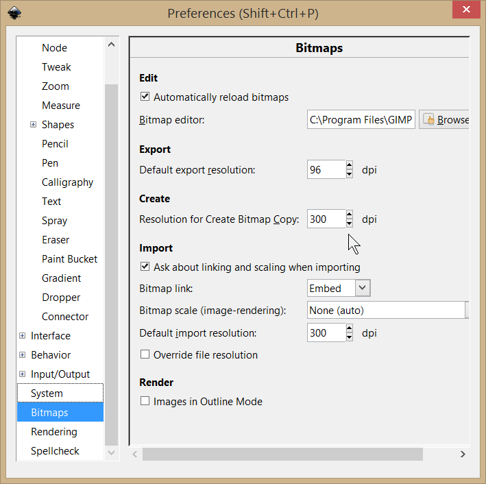

Niels wrote:Is there a setting to keep a good quality when copying to bitmap?
Yes, in the preferences menu: Bitmaps>Create>Resolution for Create Bitmap Copy...
I have it set for 300 dpi for this case, assuming it will go to print.
TD
