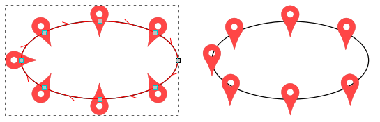

Is there a way preventing markers from rotating with the path? By default they are oriented perpendicular to the path or at corner nodes the average of the two slopes.
If this can't be realized an alternative (workaround): how to automatically place a given object at every node of a path?
Left: markers are rotating with the path
Right: markers unrotated

Open the XML editor. Find the defs section. Find your marker in the defs section. Set the value of 'orient' from 'auto' to an angle in degrees.

Ok.... this is ugly. But it does leave the markers and no path.
