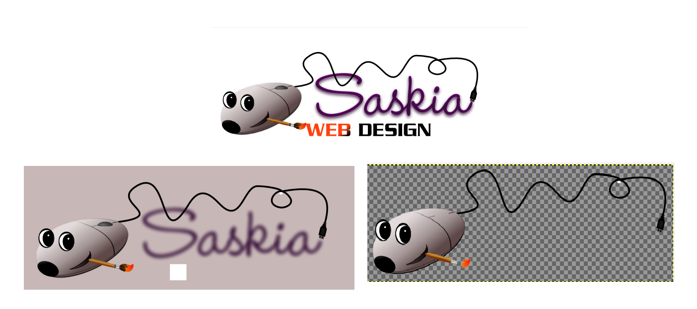

Ive created an image in inkscap i'd like to use on my website. It is a svg file. Now when i refer to the file in my html it shows in the browser but it only shows parts of the image.
I've tried to select all components of the image and group them, then save the file again to make sure all components of the image where on the same layer. I've also tried to use Gimp to change the bits that didn't show but i haven't found an option to save a svg file in Gimp. I've also tried to copy/paste the main parts of the image again in a new svg file but that only showed the same problem.
Im a 100% it has to do with the way i have drawn the image, but im obviously not sure how to fix it.
I've attached some visual for you. Image 1 is obviously how i'd like it to display. And the second image (to the left) is how it shows in the browser. The bottom image to the right shows how the file looks when i open it in Gimp.
Im very grateful for any help i might receive.
Thanks for reading and have a great day!

Which browser ? Any url or svg so we could look at what's wrong ?

I am using Firefox but it shows the same in Internet Explorer. Because my website is far from being live yet, i dont have a link for you. However i've attached the .svg file i am working with.

Too bad you removed your svg coz I don't see any obvious reason why the image doesn't show as it displays what is probably the most complex aspect of image (the blur) but fails with gradient which is simpler. I was curious about what was wrong.

Here, I have taken the liberty to bring the name to the foreground for emphasis and changed the text below to path. A white rectangle was added behind all. Looks ok in FF and Chrome.

I was just about to write that the "WEB DESIGN" part was created as a flowed text.
Flowed texts are not part of the current svg specification, they are not rendered by other porgrams.
By the way, there are a lot of small details that are off -if you use that svg design at your page, you will let everyone to look at those too.
Personally I would only use fills and no outlines for web content, by converting each stroke to outlines.

Re: Publishing SVG file - In browser image only shows partly
Here is the manual part on the flowed-nonflowed text:
http://tavmjong.free.fr/INKSCAPE/MANUAL/html/Text-Creating.html
I said I wouldn't use strokes. They are not always rendered right in the browsers.
Changed some parts a bit in this svg.
Used the convert stroke to path (Ctrl+Alt+C), break apart (Ctrl+Shift+K) and some editing on the eyes.
Retraced the usb plug with rectangles, converted them to paths (Ctrl+Shift+C), combined the two symmetric ones at the bottom (Ctrl+K),
and used the align and distribute panel (Ctrl+Shift+A) and added the parts together (Ctrl++) in a nutshell.
More details to be corrected -technically- are at the mouse buttons and on the brush.
It is something you have to experienvce with some.
Brynn created a great collection of tutorials, that can help you with learning:
http://forum.inkscapecommunity.com/index.php
Good luck!
