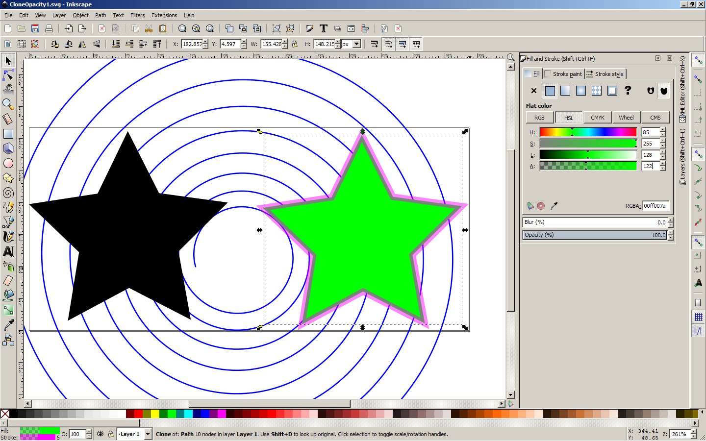

The subject of coloring clones was raised in another topic and an example shows an interesting phenomenon: Clones of an unset original seem to have the alpha of the stroke changeable, but not the alpha of the fill. The slider moves, but the fill does not change.
Original on the left with unset colors, clone on the right. Spiral in the background.
Maybe I'm missing something?

With a bit of investigation, I think I've found the cause of this "bug". The "fill-opacity" value gets set in the parent object's XML, which then prevents the clones' opacity from working. The question is whether that property should be removed when the fill is unset - I would argue that it should, because unsetting the fill also removes the UI for changing the fill-opacity, suggesting that the corresponding value has also been unset.
Using the XML editor you can remove the "fill-opacity" property from the source object's "style" attribute, then the clones will work as you expect. This seems to be the case on both 0.48.x and the current 0.91 pre-release.

Xav wrote:The question is whether that property should be removed when the fill is unset - I would argue that it should, because unsetting the fill also removes the UI for changing the fill-opacity, suggesting that the corresponding value has also been unset.
Thanks for the explanation Xav. I agree it should be removed when un-setting fill.

Ooohh, I see now. No I did not understand at first. I didn't realize you meant you were changing the clone after it was cloned. I thought you meant the direct result of the cloning.
However, I cannot reproduce this in 0.48.5. [Edit on Win7, 64-bit] So I agree that it must be a bug. I don't know if my file will be any help, if you only have 0.91pre. But I'll attach a file
When I open your file, I cannot change the opacity of the fill either -- only the stroke.

Yep reported last year; seems to be regarded as low priority:
https://bugs.launchpad.net/inkscape/+bug/1183400
At least there is a workaround by editing the XML of the original.
