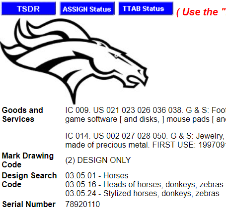

Copyright is usually 70 years.
Trademarks can be held in perpetuity. This text and image is also trademarked.
http://tmsearch.uspto.gov/bin/showfield ... 7zn3un.3.3
I don't expect the OP is going into business making knockoff licensed NFL merch. But they could. And EVERYBODY should understand that if a CNC-ready file were posted publicly here, the OP and this site are open to legal action.
