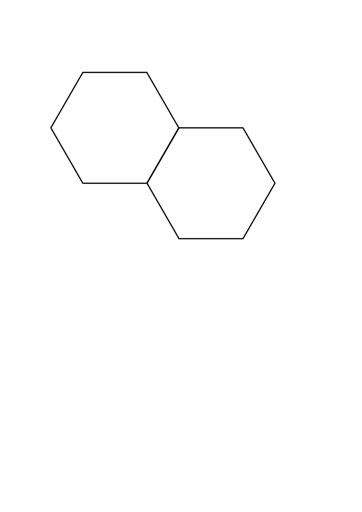

How does one snap part of a closed path to part of another?
I see some likely looking buttons down the right side of the screen, but they seem not to do anything. I have Inkscape set to snap when within 20 pixels. Use the polygon tool to draw a hexagon. Duplicate it. Convert both hexagons to paths. Now do (this is the part I don't know) and then drag one hexagon until one side overlaps one side of the other hexagon. Release, resulting in perfect alignment of the sides, so that the two nodes defining each of those sides are in exactly the same places.
What is the magic incantation that goes in at the step indicated to achieve this?
The attachment shows what I'm trying to get to. (In the SVG the nodes are pretty close together, but not right on top of each other.)

- twohex.png (21.86 KiB) Viewed 2008 times

Hhmmm, someone probably needs to write a tutorial for using snapping. Although perhaps the manual covers it well enough, I can't remember.
With snapping, there may often be more than one way to configure it, to accomplish a particular task. In this case, I would enable snapping (of course) which is the 1st button on the control bar; and Snap nodes or handles; and Snap to cusp nodes. All the other buttons should be disengaged. (In this case, it probably would not matter if other buttons are engaged, because you just have those 2 objects. But if you have more objects, the "snapper" can get confused about which one you want. It seems (to me) that some targets have preference, and if one of those is near your target, it can be hard to snap to your target. So turning off all the unneeded snap buttons really helps.) That should do it, as far as the basic settings.
Snapping can be tricky in many ways. In Doc Prop > Snap tab, there are 3 areas where you can set what I call the strength of the snap. Snap to objects is the appropriate one in this case, and mine happens to be set to 20 as well. But the zoom factor seems to affect the strength of the snap (at least it seems so to me, at times). In my experience, zooming in can make it a stronger snap, and if I'm zoomed out too far, it can be hard to make the snap. I'm not sure if zooming actually affects it or not. It may be that zooming just makes it easier see and move around.
Also, in Inks Prefs, you can choose to have only the node closest to the mouse/pointer snap. I actually find that easier to control snapping. You can also set some other things there, too. I keep the weight factor at 0.5 though.

I'd enable snap to cusp-node (at least I think that's what this button is called... the one right below the snap to edge and intersecting edges buttons), select the object I want to move and then all of its nodes (using the node tool, obviously). Then simply grab and drag one of the selected nodes to the desired position and it'll snap to the other object's node in that place. Certainly not the most elegant solution but that should do the trick.
