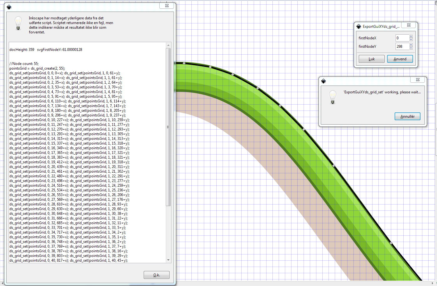

Some time ago I modified an extension (original extension ExportXY from here http://www.inkscapeforum.com/viewtopic.php?t=8826) such that it can gather and print the x,y coordinates of a path, and convert and implement the results into Game Maker code /Game Maker coord system for creating a physics edge (for easy productive work in this specific task). It can very easily be modified to just print the x,y coordinates, if there is no desire for Game Maker code. So I thought I'd just share it if anyone has a use for this.
Instructions and limitations:
Copy the content of zip file into Inkscape\share\extensions
Select the path only and run the extension from Extensions -> ExportGuiXYds_grid_set -> ExportGuiXYds_grid_set
Note that path must fulfill all of the following requirements:
- only straight lines
- only corner nodes
- best to use exact node coordinates, no guarantee decimals will work (although they will be rounded, so they might still work)
- y/x-coordinate of first node in path must be input manually by user when extension run. If nodes are added to the path in front of the first node, extension won't work (as of yet I don't know how to fix this). Adding nodes after the first node should work fine.
- merging paths ("join selected end nodes") wont work
- closed (looped) paths should work
- document height must be exact, no decimals
The extension works in Inkscape 0.48. 0.91 is not supported unfortunately.
Download: https://www.dropbox.com/s/unlr2vi7fhm3hjc/ExportGuiXYds_grid_set.zip?dl=0
