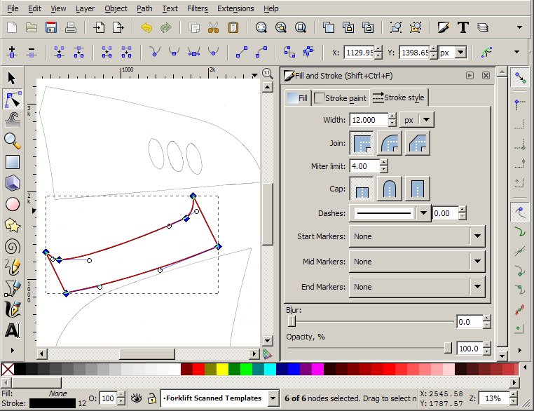

Thank you! I've read those two tutorials and also looked at your example. I am still unable to get a line to draw on the image. When I have the pencil tool selected, the image selected, and drag the mouse, it draws a box around what I covered, but the box disappears when I release the mouse. No nodes appear. How do I start this process? How do I place nodes on the drawing? Will lines snap to the two surrounding nodes?

If you're using the current stable release (0.48.5) the Preview is broken for the Brightness Cutoff option (for Trace Bitmap). So if you're looking at the preview and concluding that it doesn't work, just click the Ok button and it will trace. However, you still may need to adjust the Threshold, to get just what you want. If you're using the dev version (0.91 pre2) it's fixed.
There's always Help menu > Inkscape manual, to learn how to use the Pencil tool. Or here's an in depth tutorial about drawing lines, with both Pencil and Pen tools: http://forum.inkscapecommunity.com/inde ... ;article=7
If you want to place nodes in specific places, I would use the Pen/Bezier tool. The Pencil tool, in default settings, will draw a gazillion nodes -- way more than you need. Although the Pencil tool may be easier for a newbie to use. For the Pencil tool, try setting Smoothing to 50, then adjust as you need from there. I think by default it's set at 1 or 0, and it's hard to draw a smooth line. So some amount of Smoothing will help.

I want to thank everyone for responding! I finally managed to trace the existing outlines, size them, and even take two objects and combine them into one! (I had to cut one of the templates because it was too wide to scan and this allowed me to merge the two halves back together.)
This is a fantastic program, but the concepts take a bit of learning. I kept clicking on the curve adjustment tool, not the Bezier tool. Also, I didn't understand that the workspace MUST be large enough to house all the objects when written out. Many more things I didn't understand. But I got my job done!
