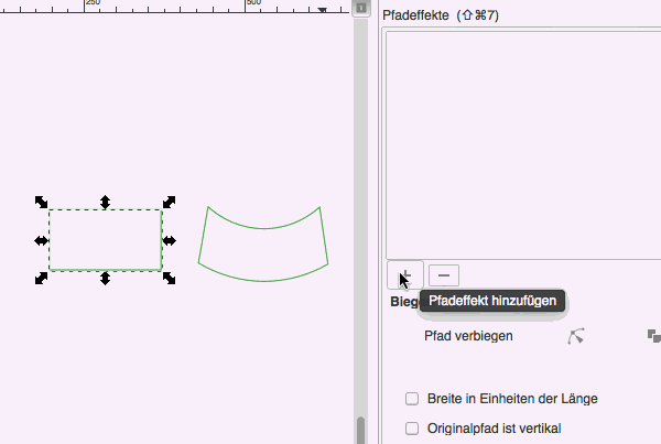

There are a few possibilities. The easiest and fastest seems LivePathEffect (LPE) Bend to me:
Or just manually adjustment via node tool:

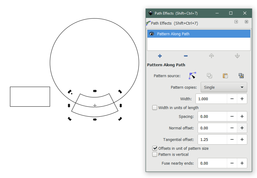

I should think the quickest and most accurate and flexible method is pattern along path, note the settings in the box, follow instructions for the path effect by copying the rectangle to clipboard first, then select the circle then choose path effect please note the circle will vanish the circle you re seeing here is a copy made for explanatory purposes
Not to be pedantic but manually or using the bend does not assure that the two sides are on radii of the circle or that the inner and outer curves have a common center

^ Didn't think of that, but it's true. Only it won't work if the path is actually a group (only works with single paths) - one would need to combine, and later break apart again, to be able to fix colors etc of the contained objects. Or one would need to have multiple paths, and put each object on a separate path.
For your example, Nike, druban's suggestion is the best way to do it. It's really easy:
