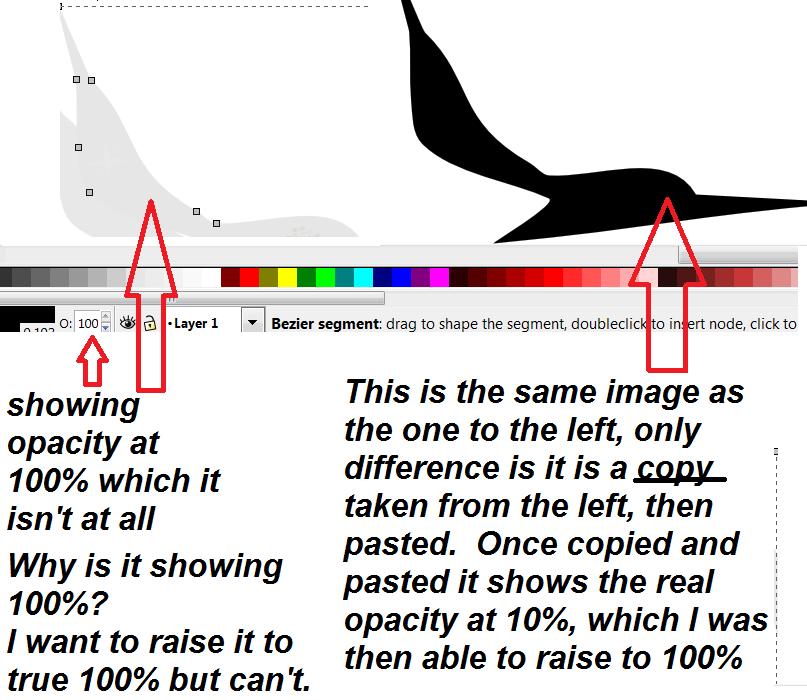

OPACITY - Get control back on opacity in an svg created in another svg ????
Hugely stuck. (Again)
Stage 1. First I have created a detailed svg - call it TREE.
Stage 2. Second I've copied TREE into a new blank svg doc.
Stage 3. Thirdly I've altered the opacity in the new copy of TREE in multiple places to fade the copy down. Up to 100 areas have been faded down to one degree or another.
Stage 4. Fourth I've copied and pasted the faded down copy of TREE into a brand new svg, then built other stuff around TREE completing my artwork.
Problem. Now that I'm sending Stage 4 to pdf TREE is appearing in the pdf as extremely washed out and lost, instead of delicately faded like in the svg. pdf quality is no good.
So I have clicked all over Stage 4 TREE's numerous parts trying to raise the opacity. However, any part of TREE that I click on is showing as being 100% opacity - which it isn't.
However, if I cut and paste a small part of Stage 4 TREE, like a leaf, then it will paste as whatever the opacity was I set in stage 3. and I can then alter the opacity.
However, if I cut and paste the whole TREE it doesn't return the opacity set in Stage 3.
Not knowing any better...I deleted all copies of TREE in Stage 3. So I no longer have the copy that was adjustable. Why did I delete? I have 40+ different TREES all doing very different things and each one needed to be faded down for re-use. I had too many files.
The fading down took about 2 months which is why I don't want to have to repeat the process from the Stage 1 original.
My questions: Is there anyway to get opacity control over Stage 4 TREE? And why, just because I coped the faded TREE from another svg doc, did it decide it was now at 100% when it wasn't at all?
- Inkscape, opacity issue after doc transfer.png (50.05 KiB) Viewed 3233 times

I couldn't reproduce the problem on Inkscape 0.48.4 r9939.
Opacity may cause some problems with pdf-s, but that's not a thing inkscape could help.
Pdf-s have a set white background, which can never be transparent, so transparency is really not a thing in pdf-s.
In svg-s, you can set opacity in two ways:
First, there is the way you faded the tree with the opacity slider/indicator.
In the codes that would look for an object with black fill and 50% opacity:
The second option, is to open the stroke and fill panel with Ctrl+Shift+A,
and add an alpha channel to the objects.
That would result for a 127 alpha value as:
Somehow during your working, the object opacity turned into the alpha channel of the fills values.
Generally for recreating fifty shades of grey, it is better to alter only the lightness values and not the opacity values in my opinion.

Re: OPACITY - Get control back on opacity
"Somehow during your working, the object opacity turned into the alpha channel of the fills values."
Is that able to be turned back to normal?
I'm afraid the rest is above me - even after 5-hours googliing what each little bit means it's well above me. ie: interpolate. group extension. hex codes. interpolate extension. ...
I don't know of any automated method how to adjust the colours, only the manual way:
Exporting the drawing to a png,
opening the png in gimp, adding a new white layer and raising the original above it, then exporting to a png without alpha,
then importing it in inkscape and turning all opacity to 100% by the indicator/slider,
then using the dropper tool (F7) with that image as a reference on the original svg's elements.
However it could turn out very painful if two or more paths with some alpha were on the top of eachother,
resulting those a darker shade originally, because to reproduce that effect, all intersecting parts have to be reproduced.
