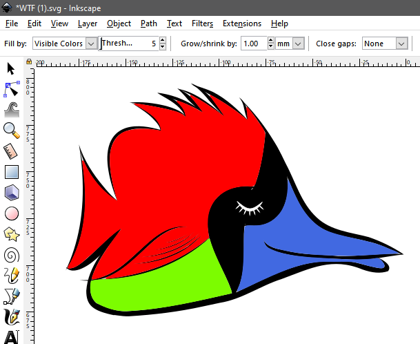

Re: Help me colour my fish... Bezier pen, and then filling!
nice fish! It took me three clicks to fill with the paint bucket note the settings in the control bar in my screenshot. You might want to check out the node tool use in the manual to fix the little white bits left
- 2019-11-01_231734.png (45.87 KiB) Viewed 1656 times
Which path tools are you talking about? Far as I could tell those are normal filled paths
its important to remember that the variation in width is achieved by making each stroke into a filled path already filled with black. To simulate a fillable outline you will have to duplicate it, remove the path effect and then fill the duplicate and move it to the bottom.
Most likely you kept the fish as a group - hence path operations not working as expected.
