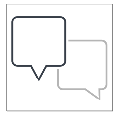

I was working on a chat bubble and finished it. It is full of " stroke " generated from " fill ". While everything looked fine, in the end there appeared an aberration at the bottom part. But the exported image do not have it. Attaching Inkscape screenshot and exported image. Thanks.
Update :
Looks like the final png has it too. But I simply generated it from a basic triangle. What could have gone wrong ?
Stroke aberration

I don't see any issues with the attached SVG file - and I don't understand why you are using the paint bucket instead of giving the triangle a fill.
Can you explain what the problem is with the 'head' of the chat bubble? Looks unproblematic to me.

Thanks @Moini .Looks like it works fine when used on Windows 10. There was a similar distortion in the " head " part when viewing through Inkscape window in Windows 10. But that was just a visual aberration. It turns out that there is nothing wrong when we export the PNG. For now that says there is no issue when used on Windows 10.
I am attaching the SVG I made using Ubuntu 18.04. That is my primary OS and that is where the distortion occurs in the " tail " as seen in screen short posted in OP above.

Finally got the solution. Used " node to corner " option suggested by @brynn. Works now :happy:

Yes, please use the palette at the bottom to fill your shapes, or open the Fill and Stroke dialog to set fills and strokes for your objects. This will give much more exact results than the paint bucket, and in many cases, will reduce the number of objects in your drawing - which is important if you want to use it on the web, or directly with other software.
The paint bucket creates a new filled object with each click. But objects can already have both a stroke and a fill, so you don't need a separate fill for your objects, or only in some very rare cases. Strike the paint bucket from your list of standard tools, and put it into the list of 'rarely used additional tools for special cases', it's going to give you higher quality for your drawings.
