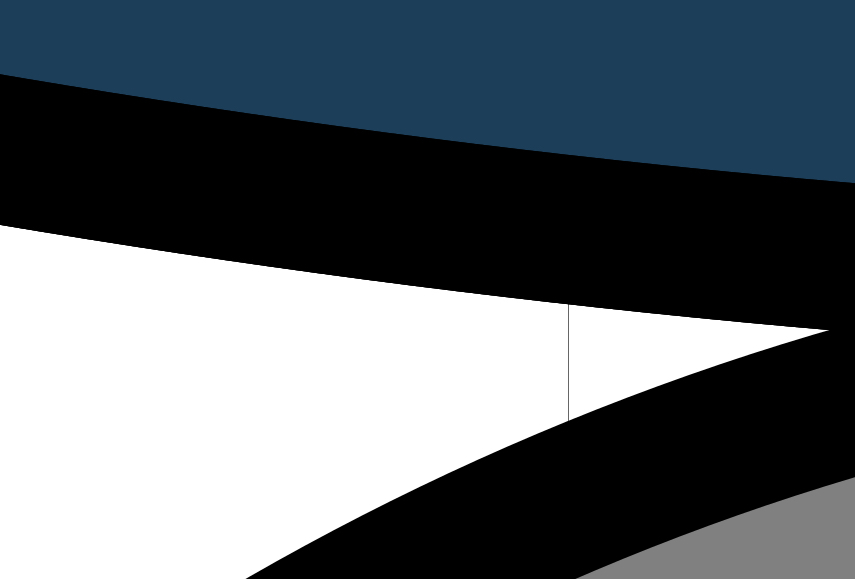

Not sure what is up. Sometimes I think its my monitor, but the image I attached makes it obvious I am not seeing things, yes?

My settings are the exact same as in that setup screen on the FAQ page I linked. I uninstalled Inkscape and am reinstalling... so I will follow everything and see whats up.
Edit: I am not sure what is up with the photo I attached... The smooth curve is a circle, the other a bezier curve, if that makes a difference? Anyways, here is the SVG file I am working with... it appears it's all paths, but for some reason some lines look pixellated - is it just the size of the drawing and how its displayed or?

So, no bitmaps in your drawing
Glad we found that out now.
The serrated lines are less serrated when you remove the duplicate black lines below - it seems their serrations add up.
Re: I got a Mac...
So its a good vector??
Whats with the serrations tho?
Re: I got a Mac...
Just the display.
If you zoom in, the jaggies don't get bigger as they would with a bitmap.
