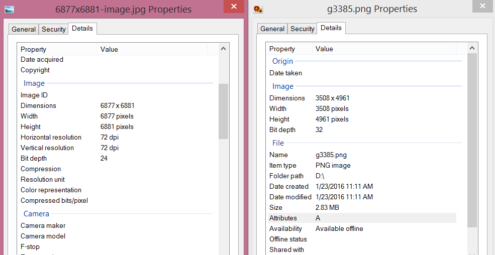

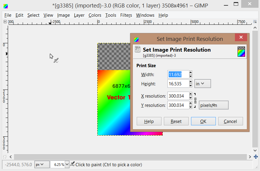

Looking at the properties of the images, note that GIMP indicates rez data (dpi), whereas only pixel dimensions are listed in the exported png.
That said, when the exported png file is opened in GIMP, the rez is indicated as 300dpi.

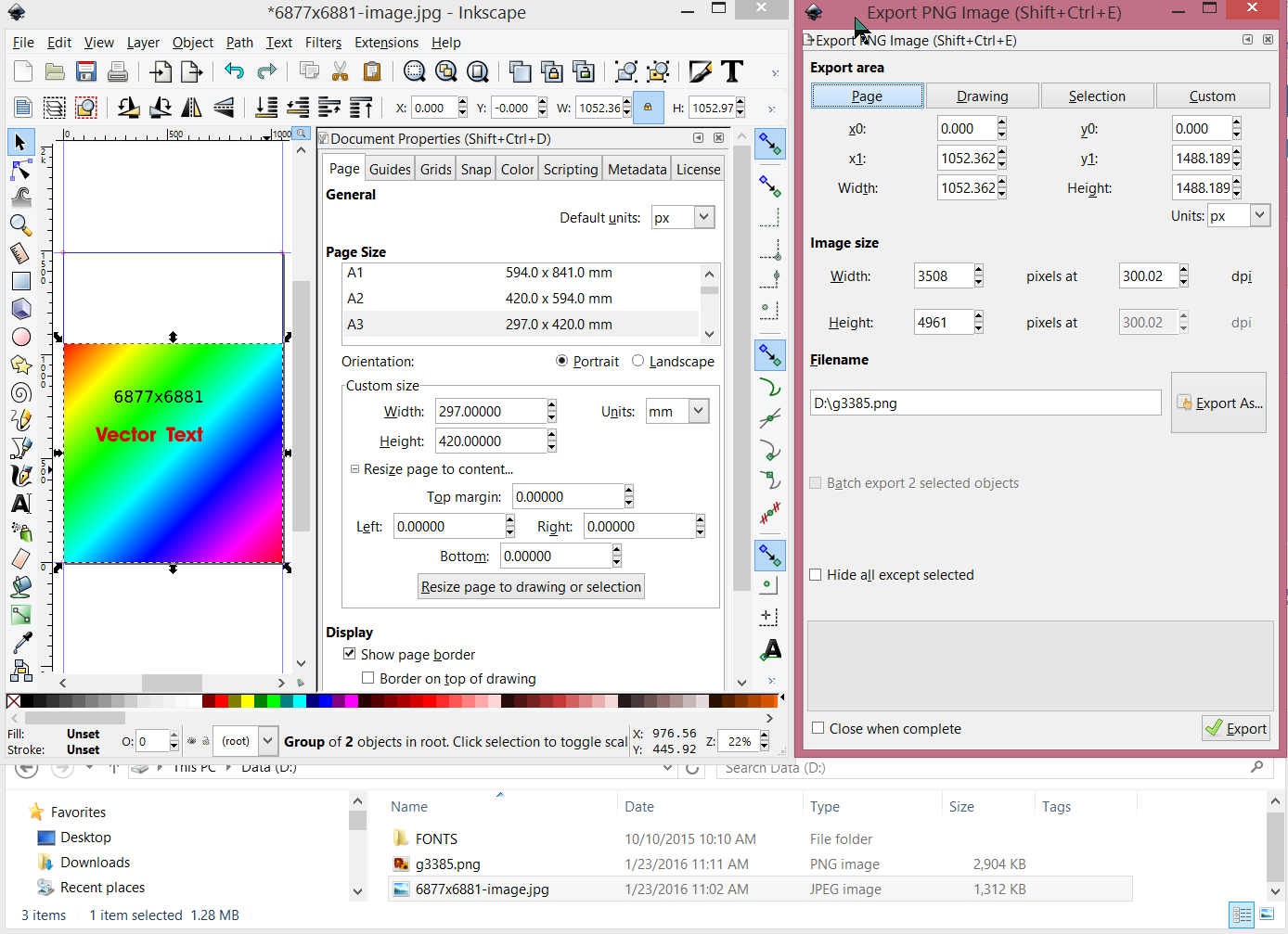

Thanks for your detective work but Its still a mystery to me..
I tried the 300 ppi A3 template in GIMP and made a gradient within it and exported to pgn
then imported that into inkscape and added some vector text, I went to export bitmap and the dpi for some reason was at 250, increasing it to 300 made the bitmap size 11693 x 16533 even tho the original image and selection was (is) 3508 x 4960..

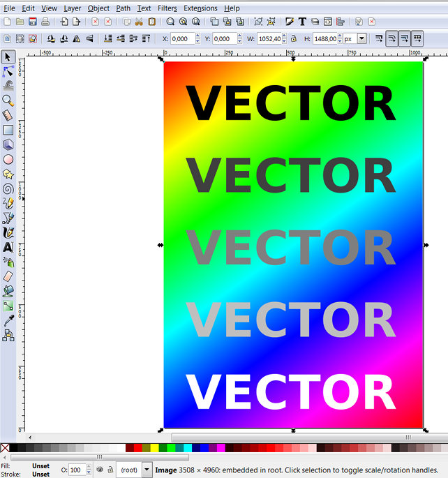

I tried to recreate tylerdurden's experiment.
Made a document in Gimp A3 at 300dpi, added a gradient, export as png.
When i open the image in Inkscape and select it, the status says 3508 x 4960p, but the selection tool display says 1052,4 x 1488px.
Why is that ?

Well than it seems the dpi of raster images is dealt with, I made a wrong assuption there.
You made an image of a certain px size, that is displayed at the bottom.
It got imported taking care of the embedded resolution -300 px appears over an inch instead of 90, so you get it scaled down by 90/300=30%, which is exactly 1052,4/1488 pixels for the bounding box size.

Depends on the settings upon import...
1052px is A3 at 90dpi.
So, Inkscape scales the image to "size". SImilarly, when opening the 6877 image Inkscape scales it to 8596.250.
6877:8596.25 = 72:90
GIMP default rez = 72px/in
Inkscape default rez = 90px/in

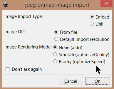

My jpeg bitmap image import dialogue box seems to be different..

redwoods88 wrote:My jpeg bitmap image import dialogue box seems to be different..
When you open/import a bitmap, do you get a dialog window?
(My linux box is down.)
redwoods88
- Posts: 12
- Joined: Sat Jan 23, 2016 12:37 am
Re: Exporting in 300 dpi
I only have an 'import' button not 'import bitmap' which takes me to a folder to select a file to import. I dont see any import settings..
maybe its different in windows as opposed to linux
redwoods88 wrote:I only have an 'import' button not 'import bitmap' which takes me to a folder to select a file to import. I dont see any import settings..
It is not about different OS/platforms but about different Inkscape versions - apparently (based on the screenshot of the preferences you posted earlier) your Linux distro still has Inkscape 0.48, whereas the current stable release is Inkscape 0.91 (which does offer import options for bitmap images).
Ahh Thank you!
I only installed it last week and assumed it would be the latest release.
(if you're on an Ubuntu-based distro, you may want to use the ppa to get 0.91: https://launchpad.net/%7Einkscape.dev/+ ... ntu/stable )

tylerdurden wrote:@Espermachine,
regarding resize: At least Inkscape does offer the choice upon import, and the choice is persistent, saving your preference.
I think this is still wrong. A bug so to speak.
A 3508 x 4960p at 300dpi does not become 1052,4 x 1488 pixels !
The recalculation should be ommited for pixelvalues. It only applies to realworld print measurements.
