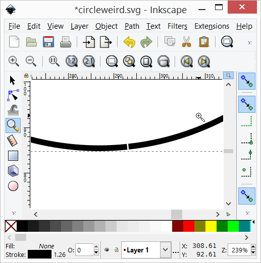

Path has 5 nodes... a closer look shows why:
The ellipse controls bar has a button at the end to close the ellipse before conversion to path.

Soo just created a new circle with the ellipse tool.. the gap was there... zoomed in....
Used the edit path by nodes tool (was it already a path?) ..clicked on the 2 circles at the break in the circle.. it joined up..
Path > object to path.. works perfectly..
Now every time I create a circle with the ellipse tool.. there is no gap anymore .. so always works... with nodes at N S E W...
thanks guys!
