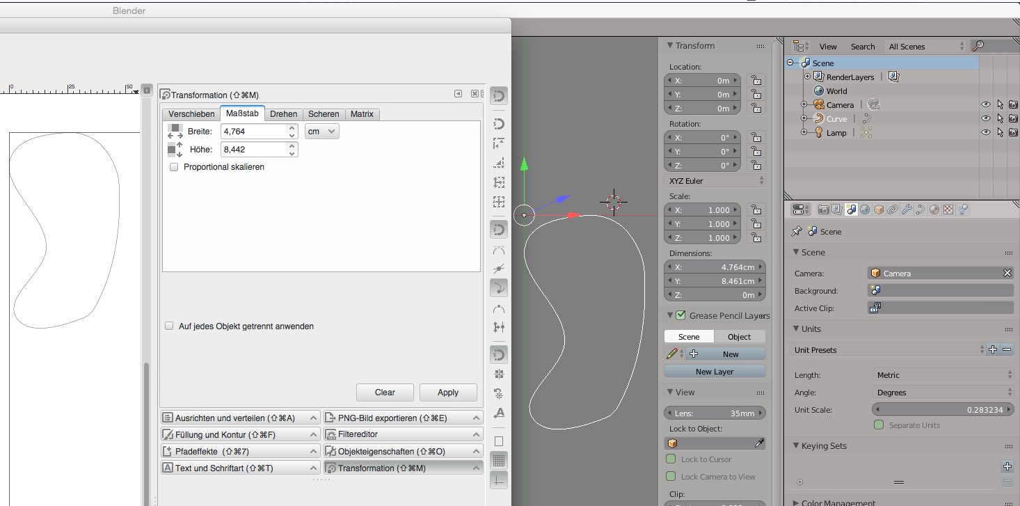

Hello..when I Export an SVG. file into blender, the dimensions of the object are at approx 28% of the original. and the Position of the zero point. (X=0,Y=O)/ is at totally different place. Anybody can help me to unser stand what happened???

probably your drawing is unitless and one assume 300dpi vs other assumes 90dpi.

I guess you ´llneed to adjust the scale value by yourself. What works here for metric units is:

Something odd with the y-scaling... I see it here too.

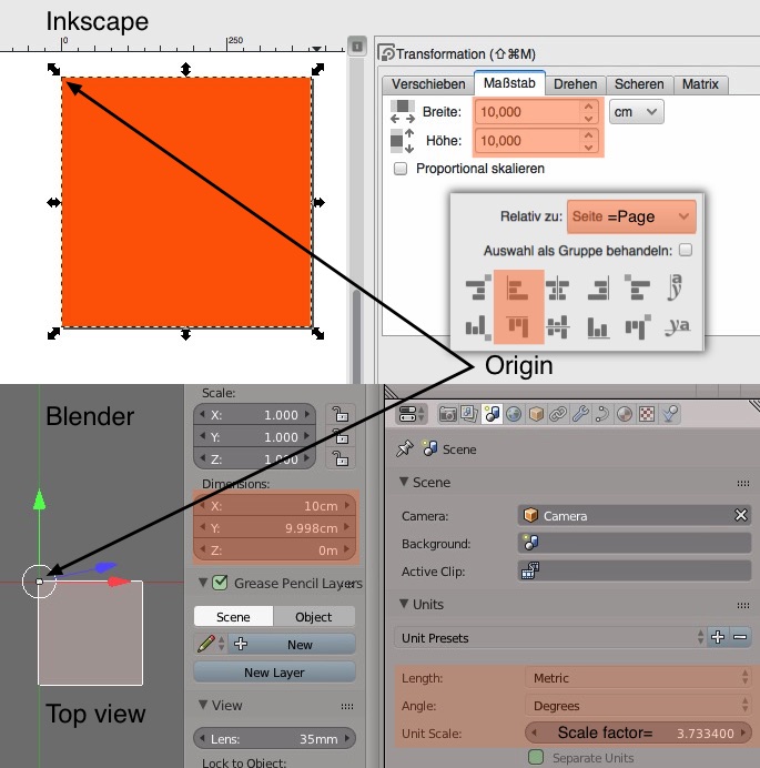

@ schoggi, Inkscape user units can now be scaled (e.g. 90/in vs. 96/in), Blender units can be scaled as well.
I advocate setting Inkscape scale 1 unit per px (same as 96/in and 3.77953/mm) before changing the display units to mm/cm/in/etc. This resolves a number of other Inkscape scale issues. (In this case Blender scale setting would be 1.066666666666667.)
