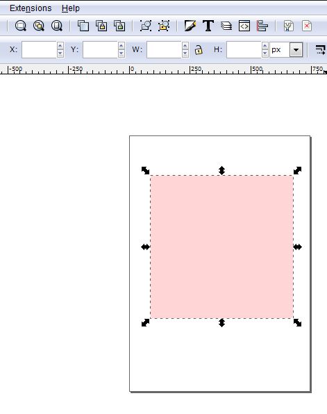

I wonder why Inkscape version 0.91 not displaying Height and Width? Refer screen shot.
Any suggestions.

Version 0.91 not showing Height and Width
- no height width 0.91.jpg (26.98 KiB) Viewed 2301 times

I would try uninstalling and reinstalling Inkscape. If that doesn't fix it, I would search Launchpad (bugtracker) https://launchpad.net/inkscape for bug reports. If you don't find one, report it. (I couldn't find a bug when I searched, but that doesn't mean there's no report.)
Be sure and include Inkscape version and system info.

Reported many times already (upstream bug in the Gtk+ toolkit with certain locale/language settings (zh_CN, zh_TW, ja_JP) on Windows only):

I have faced the following problems
a) The original height and width changed few pixels itself.
b) Could not fill in width/space even in scaling or skew fields (Shift+Ctrl M).
c) Height/width fields became blank (invisible).
Therefore installed new version of 0.91 version faced problem again then I rolled back gradually to 0.48 which is working fine at the moment.
Please note versions from Inkscape 0.91, Inkscape 0.48.5,Inkscape 0.48.4,Inkscape 0.48.2,Inkscape 0.48.1 did not work properly on my Japanese Windows Vista 32 bit. (I always install in English).

nihon94 wrote:In past I have asked a question about version 0.91 height and width fields are empty.
http://www.inkscapeforum.com/viewtopic.php?f=22&t=19580&p=74843#p74843
Further to that today found a solution and sharing.
Do as follows:
Object/Transform (Shift+Ctrl+M)
click on Scale. Height and Width can be monitored or maintained until the basic problem of 0.91 version is solved.
