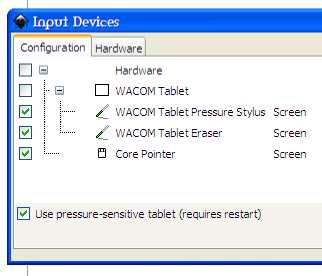

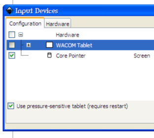

Here are some screenshots of the input devices dialog/panel. (After using a stylus to open Inkscape, naturally)
can you see if you get the same boxes and items in each list? Please note that you have to click on the little plus sign to expand the items.
Configuration tab, expand the hardware by clicking the +
Note the Wacom box is unchecked and the core pointer is. Do you see this screen on your system? I can't check the Wacom, but it doesn't matter, just expand it...
The two wacom devices listed are checkable and uncheckable. Do you have them listed and are they checked?

druban - from the screenshots it looks like you are using a recent development build for Windows, not the stable release version? Could you add details about the date and revision number of your build used for the screenshots? There have been some minor changes to the 'Input Devices' dialog recently - it might be helpful to know which revision you are at, otherwise users of Inkscape 0.48.0 might be confused because their dialog misses some check-boxes...druban wrote:Here are some screenshots of the input devices dialog/panel.
Re: tried listed fixes, but cintiq still won't work
~suv, the screenshots are from the sep 28 build of Inkscape (9797, maybe?). I don't see a version in the about splash screen (which is very lovely nonetheless). I don't remember there being any difference from the stable build in this particular dialogue, though I know it had been updated not too long before the stable build.

I checked my input configuration tab, and it's a bit different than the screenshots you're posting. I don't think inkscape is recognizing my device for whatever reason.
