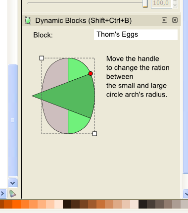

Have you tried geogebra? You can set there handles for your functions. By adding parameters to your shape that could be changed later, you could made such elements.
I don't know what's the name of such shapes, but there are circular versions of it, with the arch length as a change-able parameter, that would be handy in several design tasks. Even so it's not an every-day used shape, but it is hard to redraw it every times it is needed.
