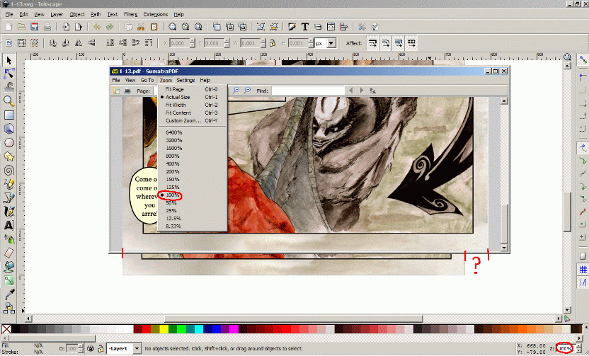

Also on a vaguely related matter... is there a reason why the page in Inkscape and the page in a PDF viewer (SumatraPDF in this case but same is true with Acrobat) appear to be different sizes even though both are zoomed to 100%?
