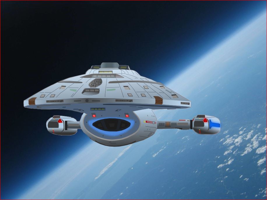

Here's a recent project I completed using Inkscape. If anyone knows How I can grab my original trace line, for some reason it's locked or it cannot be selected. Why does this happen? I tried to unlock it but with no good results I'm stuck.

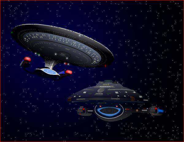

Take a look at the space picture with Voyager, for some odd reason notice that Voyager is looking ghost-like. I don't know what happened but you can see through Voyager. How can I make Voyager SOLID without losing shading, lighting & gradients? I tried adjusting the opacity this doesn't seem to fix it either. Please help. Thanks

It seems you achieved that lighting by using like a white to transparent gradient over one object with a solid colour.
Which object doesn't show up on the starry background.
Maybe you used layers, and somehow the background's layer is above the spaceship's lower object's layer?
Or if all on one layer, the starry background is not at the bottom.
Select the background and press End; if result is not satisfactory, check the layers tab (Ctrl+Shift+L) and move it's layer to the bottom.

Is there an email address I can use to send the Enterprise, Voyager, & star space background SVG files to you? Perhaps you can look at it & determine what my issue is? I tried your steps with no avail. Why didn't the same see through issue take place with my Enterprise? The enterprise looks ok, but the Voyager looks ghost-like. I used the exact same method. Also, the main trace line that was used to trace the voyager is locked. I can't select it. How do I fix this issue?

Now I could see the original files and correct them.
There was some transparency with many gradients so took the easier way and added a solid white path below the spaceships and grouped them together.
Another thing I have no idea how could happen, but there were some parts in the files unselectable, without being on a locked layer.
So checked for the codes, and realised there were parts added like this:
Never knew before you could lock things inside the document with that sodipodi:insensitive="true" tag.

sodipodi:insensitive="true" />Never knew before you could lock things inside the document with that sodipodi:insensitive="true" tag.

In inkscape 0.48 go to Menu>>Object>>Unlock All, if you want to unlock objects, or Unhide All, if you want to show all the hidden objects.
Even More. When you have an object selected, right click, then click in object properties, it appears a dialog box. At the bottom there are options to hide or lock the object. Which it proves to be usefull some times, ... but also dangerous, if you forget that you locked several objects. The "sodipodi:insensitive" attribute is affected for this control.
I wasn't sure if that feature was the problem, but Lazur with his last comment confirmed it. I was hoping to see the original SVG, also.
