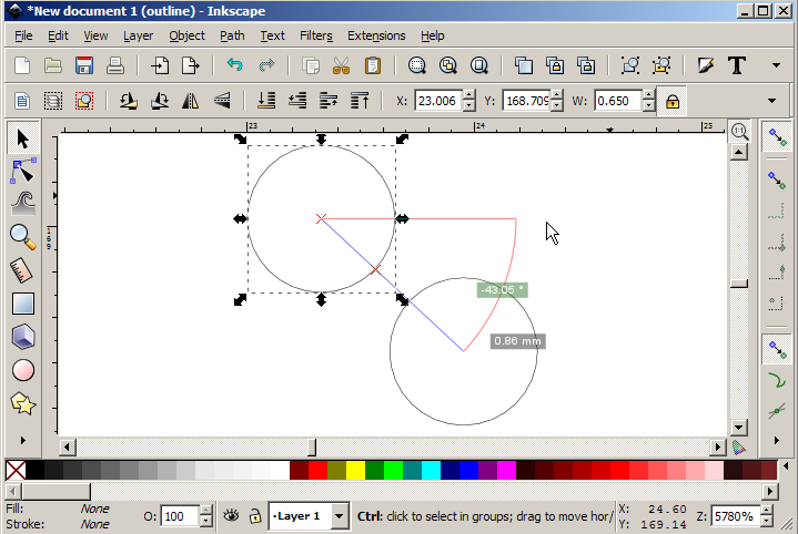

This especially goes for circles, where I right now want to move a circle and place it with its center directly at a guide point.
A little bit about the project:
I'm making a laser cut acrylic or plywood board that will function as a test jig/programming adapter for a specific circuit board. Pogo pins will protrude from holes in the board exactly where the exposed copper pads for JTAG connection is placed on the circuit board. I've used guides to map out the exact location of every programming pad and test points at the circuit board, and now I simply want to draw circles at these test points.
1. Move a circle relative to its center. I know I can draw a circle and size it from its center, but some times I need to move a circle to a different coordinate but then I can only drag it from the edges. Making the guide points to where the edges of the circle will line up makes no sense and requires extra math to figure out because not all circles are the same diameter (if all circles were the same diameter I could just place the guide point one radius length to either side of where the circle will sit).
2. Be able to zoom while measuring. When using the measurement tool, the zooming function seizes to exist. If I scroll the mouse wheel nothing happens. I want to make a measurement over a longer distance than what is shown on the sheet at my zoom level. So I zoom in to a guide point, start measuring from there, and I want to zoom out again, pan across the sheet and zoom back in at a precise location somewhere else to end the measurement. If I middle click to zoom in/out, the measurement is canceled.
3. Make a measurement and have it sit there is a guide. When I release the mouse button after taking a measurement, the measuring line disappear. I want to take a measurement from a guide point, measure out where I want my next guide point, and have the measurement sit there (like a guide point maybe) so I can place my next circle there. To do this I can use the Bezier tool which measures its length while drawing and sits there when I release it, but I think its messy to use a shape as a tool for this as it clutters my design and I must style each Bezier line to be either a guide or a permanent shape.
4. Make a circle with a precise diameter. I have my grid set to 0.01mm. When I draw my circle I have it snap to the grid and make a circle with a diameter of 0.64mm (I would like 0.65, but it only snaps to 0.64 and 0.66?!). If I then click the circle again using the select/arrow tool, the tools controls bar now shows the width and height of the circle to be 0.67mm. This is frustrating, because if I then re-size it from the tools command bar it does not size relative to the circle center anymore, and any re-sizing misplaces the circles relative to the guide point. I can not move the circle back with the center on the guide point after re-sizing, see point no.1.
I'm starting to think Inkscape is simply not made for the tasks I want to use it for. But then again, are these features not there because they're not wanted or because they're not fit for this type of software? Could I expect them in a later release?
Coming from sketchup, am I missing something?

I use Inkscape with an Epilog laser. Inkscape is quite precise, I don't think there should be an issue with .65mm circles. I'd use no stroke/fill and View in Outline mode.
To navigate while using the measure tool, use +/- for zoom, shift-arrows for pan (I know, holding mouse and shift and arrow is not so easy).
To get the measure tool to freeze/persist, press the spacebar.
To snap to circle centers, activate object centers or rotation center in the snapping toolbar.
Measure tool will snap to centers.
Depending on your laser, you may need to set a stroke for cutting. For export to dxf, not needed.

I'm not familiar with the type of project you're working on, like the others who replied. So I'll just give you a straight answer to your questions.
1 -- You'll want to look into Snapping http://tavmjong.free.fr/INKSCAPE/MANUAL ... pping.html Snapping is a quite complex feature, which takes some time to learn. Unfortunately for snapping to the center of a circle, you have to give it some kind of fill, temporarily. It could be a fill that is 99% transparent, so you can still see what's behind it (find the other snap target). Then you can not only drag it by some inner location, and not just by the outer border, you can also precislely place it on the spot.
Note that having all the snapping options on the toolbar enabled at once makes it extremely difficult to snap exactly as you like. I find it better to have only the buttons engaged that I need for each specific move. Otherwise, everything wants to snap to everything else, and it's impossible to get anything done!
2 -- I just tested this with 0.91, and it works. Even while you're in the middle of measuring something, you can press the `/~ key which will take you back to the previous zoom level, and the Measure tool is still keeping its info. Each time you press takes you back to the previous. (Shift + that key, goes the other way)
3 -- We still have the old Measure Path extension. Extensions menu > Visualize Path > Measure Path. That creates a path that remains on the canvs, and also writes the distance as a new text object. You could delete the text, if you don't need it.
4 -- You can use Object menu > Transform > Scale to scale it precisely and from the center

Back from testing.
Oh my that was a hassle. I still ask why normal mouse-zooming and -panning is killed while measuring. I never hit the exact place to zoom in while panning, so I have to do it in several steps: zoom out, pan, zoom in, pan some more, zoom in final bit. By the way, it was ctrl+arrows that worked for panning here.
This is useful, great tip! Still would like it to stay there as a guide though. The measurement is lost when I use the measuring tool again, and by switching to the select tool each time I have to change back to measuring tool for each measurement. Quite ineffective when placing several guide points after each other.
Yes! Now if I activate snap centers and grid at the same time, I can move a circle around having its center snap to grids and guide points. Beautiful.

HSPalm wrote:by switching to the select tool each time I have to change back to measuring tool for each measurement. Quite ineffective when placing several guide points after each other.
You might try using guides... if you double click on a guide, you can enter parameters, absolute or relative.
HSPalm wrote:now it's "File format:eps,dxf,cdr"
In that case, I'd use no stroke or fill, and set Menu: View>Display Mode>Outline. Export DXF.
That might also help with the difference between what you see when you draw a circle and what you see when complete (no added stroke).
