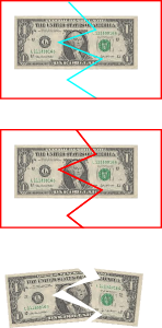

1. I assume you are starting with a raster/bitmap image of a dollar bill. In the first step you see the bitmap, a rectangular path (
then ctrl+shift+c to convert to path), and a "cutting" path drawn with
. Duplicate the bitmap and send both copies to the back of the z-order.2. In this step you see what you get if you select the rectangle and the cutting path and do Path>Division. There are actually two paths now that match up like puzzle pieces.
3. To get this result you select one copy of the bitmap and one of the "puzzle pieces" and do Object>Clip>Set. Repeat with the other copy of the bitmap and the other puzzle piece. I have rotated and moved the pieces to show that they are not connected but do match up.
