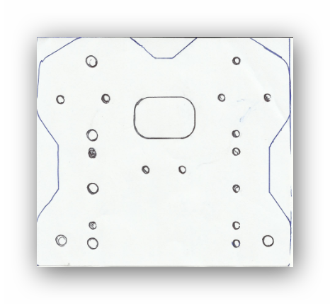

I've got a scanned image of a front plate of a CNC router which I'm trying to align the holes and find the center of. But every time I try to select the left hand set of holes the whole scan moves with the mouse. I'm drawing straight lines with the Bezier tool to help me with the alignment.
I wondered if there was a better way of doing this.

Sorry.
The graphic file was too big for the above post.

If you know the measurements you are much better off creating this from scratch.
Import the image into Inkscape
Create a new layer called background,
Move the image to the new layer and lock the layer (click the padlock).
Create guidelines for holes on the left side. (As the design is symmetrical you only have to "draw" half of it, select the half, duplicate and flip horizontally.)

Thanks a lot for the explanation Ragstian
That's the problem, all the sets of plates that have been cut have the holes in the wrong places and once you add the wheels to the plates you can't get the 'V' rails to sit in between them. I'm already on the second set from another source and they are still not in the right place.
I was going to make a template of each plate and transfer the holes to a piece of 12mm ply and drill the holes a millimeter or so off center. once I find the right setup I'll then drill plates in 4mm steel to make a set that actually works.
Drawing my own out sounds like a better idea. I'll give it a go.

If you have the V-rails and the V-groove bearings in hand (so you can make measurements) it's relatively easy to calculate the exact position of the holes in the plate.
Even if this takes some time it's quicker and much more accurate than the "trial and error" method. By using eccentric spacers on the bottom pair of bearings you can adjust any inaccuracies out of the sliding plate when mounting on the rail.
I find it strange that the original plate is "incorrect" as it's probably part of a already used design.
Any errors in the hole spacing would have been corrected by the designer or caught by one of the first few customers.
