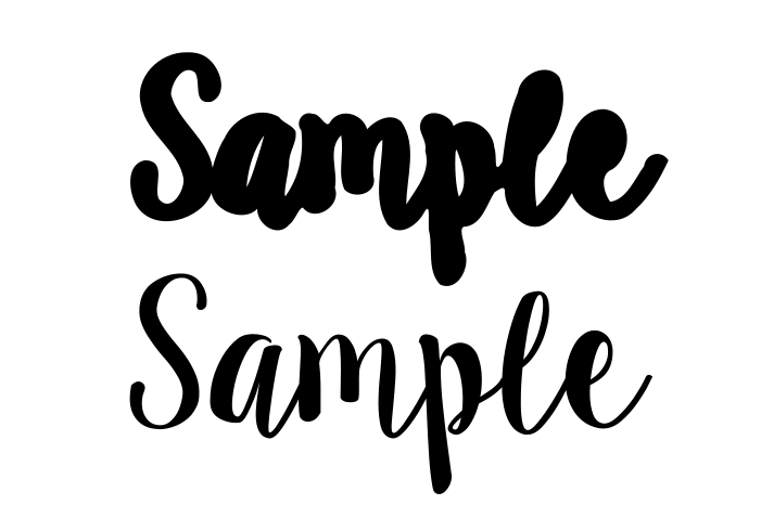

Every time I go to make a font thicker I used to do it by selecting outset but now when i do so it makes the font way to thick and bumpy. What can i do to fix this?
- Screen Shot 2017-01-25 at 2.50.19 PM.png (47.2 KiB) Viewed 2501 times

You can either (temporarily) make the text bigger, and then apply the outset, or you could set the outset step amount in the preferences, at Edit -> Preferences -> Behavior -> Steps : Inset / Outset by
Re: Outset not working
Or use Dynamic Offset, where you can drag to set the distance. Or add a stroke, which width can be varied, rather than outset.
