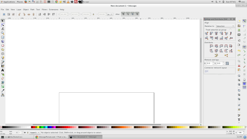

I'm running Inkscape on Linux and Windows.
We used to see the align and distribute menu. It's not a big deal but that menu is nice to use.
Is there a way to get it back.
display align and distribute
- inkscape-no-menu.png (82.08 KiB) Viewed 3472 times

It doesn't show using View - Show/Hide toolbars?
Re: display align and distribute
No . it does not. Right now I'm using Linux (Centos and Gentoo)
Not a toolbar, it's a dialog, so F12 is the show/hide shortcut.
If that doesn't get it back, maybe it's off-screen somewhere?
https://bugs.launchpad.net/inkscape/+bug/1244397
Hope this helps...
Exit from Inkscape and open this file with a text editor:
~/.config/inkscape/preferences.xml
...look for:
id="dialogs">
...and you'll see an XML record for each of the dialog windows with their positions set with something like:
x="456"
y="231"
...just replace those numbers with something like 100 and 100 - and the next time you open Inkscape, the dialog will default to opening at that location...then you can move it someplace else, cleanly exit inkscape again...and everything will be OK from then on.
Hope this helps...
tylerdurden wrote:Not a toolbar, it's a dialog, so F12 is the show/hide shortcut.
Bug #1244397 is a problem specific to Inkscape on (Mac) OS X 10.9 or later, and does not track issues reported by Linux or Windows users. AFAICT 1885 only mentioned using Linux and Windows …
[edit] Off-screen Inkscape dialogs on Windows are tracked here: Bug #379463. AFAICT there are no such reports from Linux users so far.[/edit]
Ja, I didn't mean to imply that the issue was the bug, but to indicate the source of the workaround for off screen windows.
