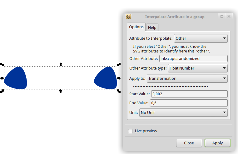

I thought this could work, but it doesn't:
Not sure if it's a bug, or perhaps I'm doing something wrong.
Re: Automating Export of .png files
(had it set to 'Apply to Tag', too. Also tried with dots as decimal separator.)
Guess it needs to take the namespace into account and to set it separately. Probably not hard to do...

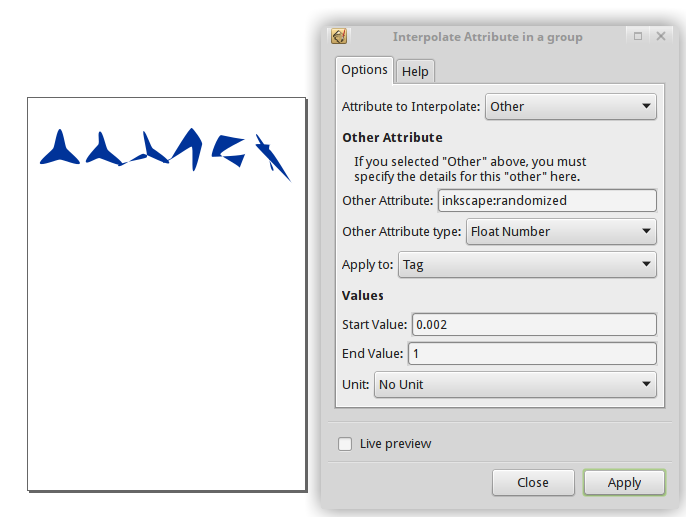

Works now in my version, but wow, there are so many bugs... and Inkscape crashes regularly when you change a number in the fields.
- Bildschirmfoto_2017-10-03_03-06-06.png (45.8 KiB) Viewed 1623 times

It will work for both, the screenshot was just an example. However, randomized will be randomized for every step, and not a step-wise change (although I suspect that Inkscape's 'random' isn't so very randomly here). Fixed a couple more issues with the extension, while I was working on it, too (e.g. it completely ignored the units... ?!?)
What doesn't work so well is varying the number of spikes of a star, as that seems to require changing another parameter in the SVG in unison.
