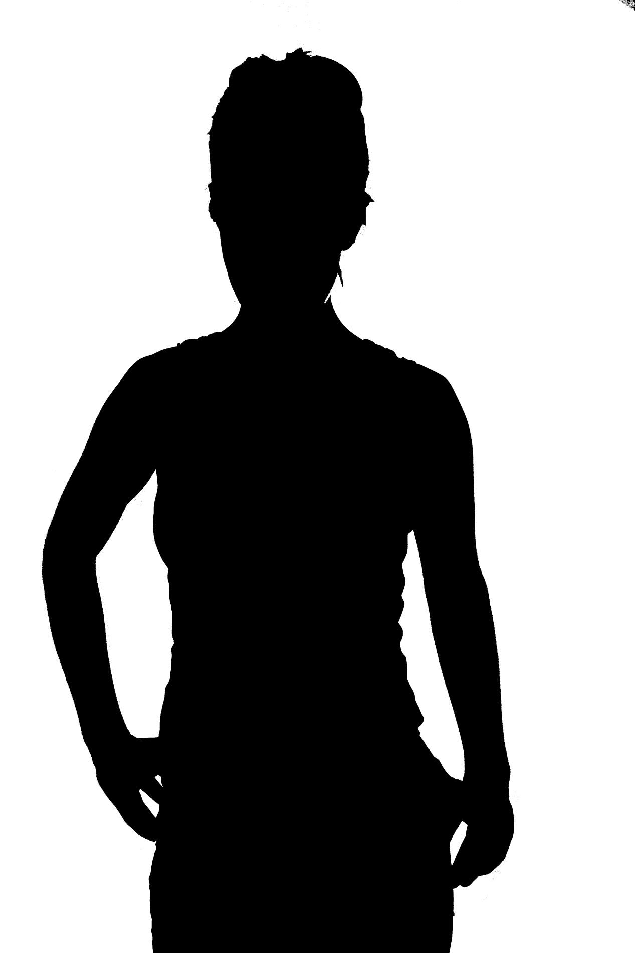

I tried to enclose my best silhuette so far as an EPS file (converted usind online-convert.com) but did not succeed (the website simply jumped back to a blank reply). Therefore I enclose it as PNG, which is the end product of the work I did in paint.net (mentioned in my first post). As you can see the edge is not even. Could Inkscape smooth the edges perhaps?

Wow! Yes, that is an excellent solution, to use Paint Bucket tool instead of vectorizing with Trace Bitmap, or whatever. I've done that very, very quickly for you, and attached below. You can see that perhaps too many details have been lost? A little piece of hair under ear on right (left ear), for example. I did with these settings: Threshold 25, Grow/Shrink 0.50, Close gaps None. But perhaps some tweaking could add some more detail, if you need. (Also, you can change to a different color -- that's just my tool's color.) Make sure to remove any stroke, for the best clarity. For my Paint Bucket tool, I have no stroke. But yours might use a stroke.
Actually I'm not following Jelle's method. I don't understand "- Draw a bounding box around your silhouette" or why any node editing would be needed. All I did was import the black silhouette that you made, zoom out so that entire black area fits Inkscape window, engage the Paint Bucket tool, and click on the black area. Period, that's it!
